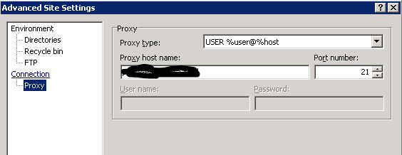

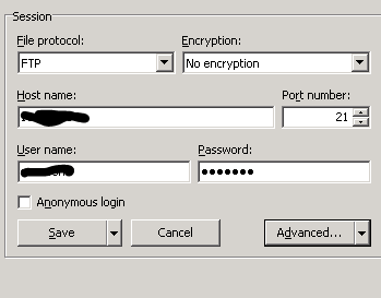

in an FTP session I've configured an Bluecoat Proxy in the "Advanced -> Connection -> Proxy" tab. When I try to login, it fails. To me it seems, as the proxy setting is not honored, see log excerpt below:
. 2014-05-22 13:24:29.537 Proxy: none
Any ideas?
I've configured WinSCP following the hints here:
http://bluecoat.force.com/knowledgebase/articles/Solution/HowdoIsetupWinSCPFTPclienttoworkusinganexplicitFTPconfigurationthroughtheProxySG
WinSCP 5.5.3 (Build 4214)
Thanks and regards,
Tilo
