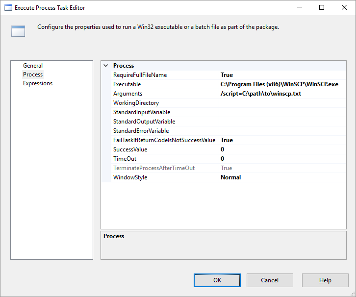

In SSIS/SSDT, add new Execute Process Task to control flow of your package. In the Execute Process Task Editor:
- Put path to WinSCP executable (by default
C:\Program Files (x86)\WinSCP\WinSCP.exe) into Executable; - In Arguments specify
/script=<pathtoyourscript>(Alternatively you can specify all commands here using/commandswitch, as used the command-line template that WinSCP can generate for you); - You may want to set WorkingDirectory to path, where you want to download files to/upload files from, if you do not use absolute paths in your script.
