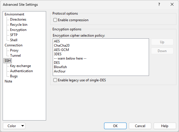

The user can specify his / her encryption algorithm preferences. Options are: AES (SSH-2-only), Blowfish, 3DES and DES (SSH-1-only). It is possible to enable compression. A connection can be established through a Proxy (HTTP, SOCKS 4/5 or Telnet).
