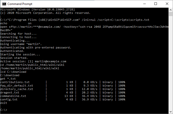

Save the script to the file example.txt. To execute the script file use the following command. As the script connects the session itself, using the command open, omit the session command-line parameter.
winscp.exe /console /script=example.txt
