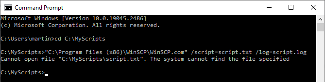

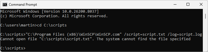

Inspecting Console Output
In rare case when WinSCP fails even before a session starts, the session log file is not produced. In this case the errors will display on WinSCP console output.
If you run WinSCP or wrapper batch file directly from Windows Explorer, the console window will close very quickly, so you might not be able to read the output.
When debugging script, it always better to use a console window, like Windows Command prompt or PowerShell. Additionally, use winscp.com console interface tool to run the script, as it (contrary to winscp.exe) outputs to the same console window, where it was started from.
Alternatively, when using a batch file, you can add pause command to its end to prevent the console window from closing immediately.
winscp.com /ini=nul /script=script.txt /log=script.log pause
