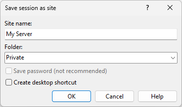

If you want to save your session configuration, use Save button on bottom of Login dialog to create a stored session. You will be asked for name of the stored session. From the drop down menu you can select name of any existing stored session to overwrite it.
If you have specified a password on Login dialog, you will have an option to save it as well using Save password checkbox. However this is not recommended. Read more about security when storing passwords.
Note that even when you have already logged in, you can still store the opened session.
