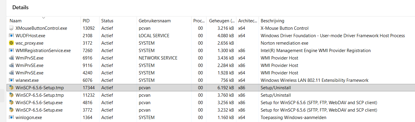

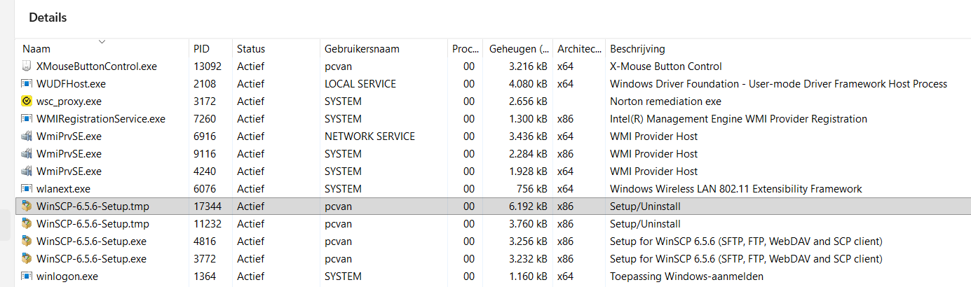

When you click on the URL and WinSCP installer starts – please go to Task Manager's Details page, show Command line column, locate all WinSCP and WinSCP installer processes and post their commandline.
Btw, did you try reinstalling WinSCP?
Thanks for the screenshot. But you haven't shown the Command line column (right click the list header and choose Select columns).
WouterNL
6
Screenshot with command lines
For security, I've checked the private option for the attachments.
  • WinSCP-Commandline.png (38.3 KB, Private file)
