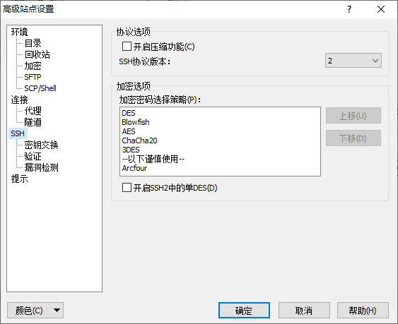

I also noticed that 5.0.7 is much slower, with blowfish I can achieve only around 4MB/s max, with AES I'm getting 10MB/s on 100Mbit network, but cpu usage is very high. Is winscp using AES-NI instruction set on cpus which support them?
43,136
I'll consider rolling back the "default to Blowfish" change.
AFAIK, PuTTY (WinSCP uses PuTTY code for SSH implementation) does not use AES-NI. I suggest you propose the change to them.

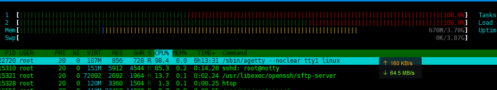

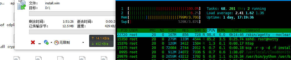

having network speed and hard drive speed many times over the "limit" you'll see your CPU max out before anything else does, using HPN you'll see speeds go up without changing winscp
tl;dr your server cpu single threads limit your transfer speed, it isn't winSCP.

Re: pscp is very faster
anjia wrote:
winscp version:5.15.1 Portable
OS version: win10 1809
linux server version: centos 7.6 mini
winscp options:
close compression
algorithms is DES
WinSCP speed is 400KB/s~500KB/s
Pscp speed is 60/s-70MB/s
What version of pscp? Are you really using ancient DES (not 3DES) with WinSCP? What do you mean by "close compression"? Can you start a new topic for your question? (as this one is quite long already)
