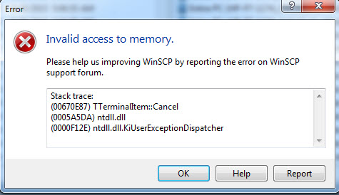

Invalid access to memory - TTerminalItem::Cancel
I had started a queue transfer (background) session with "transfer files individually" set and "New and updated files only" selected and a max of 7 simultaneous uploads set in preferences. It correctly started the transfer session by first determining that many of the 161 files were older than the FTP site files and didn't need to be transferred before it found the 7 files that did need to be transferred and initiated the simultaneous transfer for those.
I then scrolled through the queue window and saw the files that did not need to be transferred were still listed but were "grayed out" and said "Completed".
I then selected one of them and clicked on the "X Remove selected queue item". This is what caused the error message.
This is repeatedly reproducible.
I hope this helps. This looks like a great piece of software but I've only used it for about an hour so far.
WinSCP 5.7.5
Invalid access to memory.
(00670E87) TTerminalItem::Cancel
(0005A5DA) ntdll.dll

rickdees78@...
Error Occurs when trying to cancel a download that that has 'completed' but not disappeared.
The cause of this is done by another error. When attempting to download from an ftp with to many downloads. Say I have 3 downloads set but the server only allows 2 connections from Host. The third pops up an error. If you okay this message, hit settings between the error messages and change the background to 2. The third becomes a greyed out 'Completed' that will not disappear. This prevents any other queued items from starting (the first error), this is the result of the second error when trying to cancel the completed item to restart queues.
WinSCP 5.21.6
(00D0315F) TTerminalItem::Cancel
(00087B7F) ntdll.dll

steven.bauer@...
This happened when I tried to cancel an item that was in the background transfer queue.
WinSCP 6.1.2
(00D1D6E7) TTerminalItem::Cancel
(00087A7F) ntdll.dll

rickdees78@...
This happens when trying to download from a host and there is 'to many clients' connected. It gives the warning message and 'okay' box that repeatedly trys to open up and continue to download even though there are to many users.
This specific error happens during that point where one tries to open settings between error warnings and lower the download count to clear the error. When exiting settings, the error box will be waiting. Clicking okay at this point causes the problem and shows the file attempting to be downloaded as 'complete' that ever goes away during that connection but limits the future download spot.
IE: if there were 3 spots available, with the 'complete' there after the error trying to download 4, only two remaining will remain. It's quite annoying. Has been a problem on every build of WinSCP over the past 3-5 years.
WinSCP 6.5.3
(00C46363) TTerminalItem::Cancel
(000B0F5F) ntdll.dll
(0007ACBA) ntdll.dll.KiUserExceptionDispatcher

JYoungCommercial@...
SUMMARY:
When I try to remove (delete) a transfer that was marked as "Complete" in the transfer queue then I get the error message.
ADDITIONAL DETAILS
I attempted to initiate the transfer in question (from a server to my desktop) while other transfers were already happening (from the same server).
The server rejected the request and WinSCP set the status to "Complete".
Every time I attempted to clear the transfer in question from the queue then I received the error message (below).
This has only happened with this one specific transfer but every time I attempt to delete it then I get the same error message.
I have never received this error before.
Thank You!
ERROR MESSAGE:
(0008818F) ntdll.dll
(00074711) ntdll.dll.KiUserExceptionDispatcher
WinSCP 6.5.3
