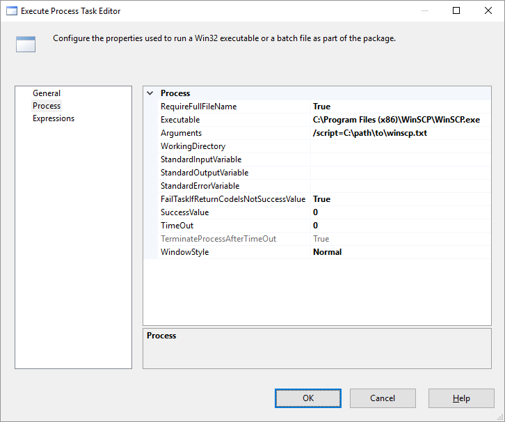

SSIS task
In SSIS, add new Execute Process task to control flow of your package. In the Execute Process Task Editor:
- Put path to WinSCP executable (by default
C:\Program Files\WinSCP\WinSCP.exe) into Executable; - In Arguments specify
/script=<pathtoyourscript>; - You may want to set WorkingDirectory to path, where you want to download files to/upload files from, if you do not use absolute paths in your script.
