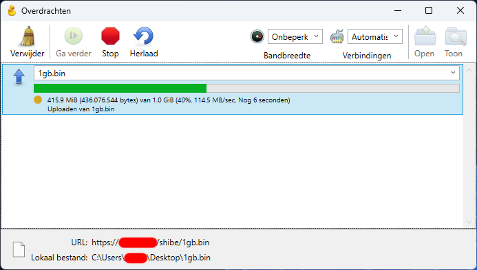

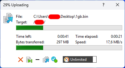

I also have this issue. WinSCP v6.5.7. Not Amazon S3, but S3 compatible with SeaweedFS v4.48.
Cyberduck maxes out my wireless connection at ~115 MB/s. WinSCP maxes out at ~18 MB/s. Disabling or enabling "Optimize connection buffer size" makes no different. Changing the speed from "Unlimited" to "Unlimited" also makes no different.

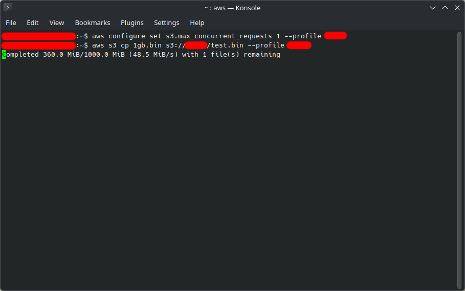

Additional testing on Linux machine with awscli, same system but from a VM this time.
s3.max_concurrent_requests 10 (default): ~100 MiB/s -> ~105 MB/s
s3.max_concurrent_requests 1: ~49 MiB/s -> ~51 MB/s
So I have no idea what WinSCP is doing. Too bad. I like this tool for my file transfer needs.
