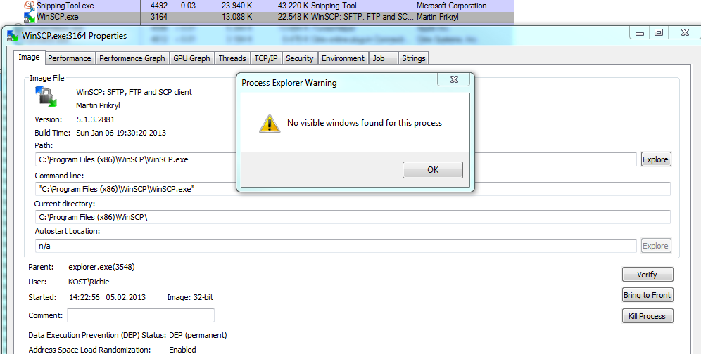

i am facing some troubles after i have updated my Win7 prof. from WinSCP 5.0.6 to 5.1.3.
After the logon screen the Application disappears and the GUI is not reachable. It can only be killed trough the Task Manager or the Process Explorer. The Winscp.com with the console interface works fine.
Instancing the winSCP.dll(5.1.3) o this machine freezes the whole development environment, which can not be killed with the Task Manager, only rebooting is possible.
Any suggestions ?

Description: During the Logondialog everything seems to be OK.
Description: ProcessExplorer is unable to bring WinSCP to front ...
