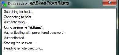

i am facing some troubles after i have updated my Win7 prof. from WinSCP 5.0.6 to 5.1.3.

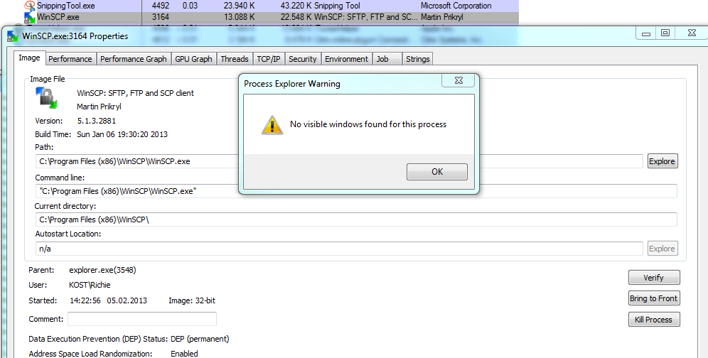

After the logon screen the Application disappears and the GUI is not reachable. It can only be killed trough the Task Manager or the Process Explorer. The Winscp.com with the console interface works fine.

Description: During the Logondialog everything seems to be OK.
Description: ProcessExplorer is unable to bring WinSCP to front ...

Solved !
After deinstalling Daemon Tools Lite from the System, everything is working as it should.
