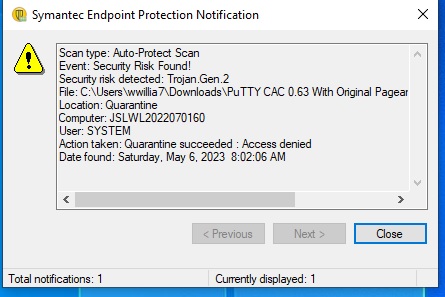

williawh
Houston, Tx
FYI - Attached File Corrupted
PuTTY CAC 0.63 With Original Pageant.zip has a Trogen.Gen.2 according to my Symantec Endpoint Protection...
Description: Trogen.Gen.2 virus detected
Re: FYI - Attached File Corrupted
@williawh: Thanks. Might be a false positive. While Virus Total has 10 positives, all are quite generic (same as yours). In any case, as the binary is severely outdated, I've made it inaccessible to the public.
