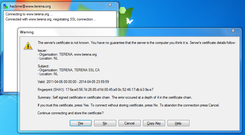

I am trying to connect to our Pure-FTPD server (Ubuntu 8.04 LTS 32-bit, pure-ftpd-postgresql 1.0.21-11.1ubuntu2).
This server is configured to do TLS.
Upon connecting, I get a certificate warning. The issue is not with the fact that there is a warning, it is about the content of the warning.
The warning message seems to mix up the certificate Issuer and the certificate Subject.
Don't get fooled by the names, in this case the "Organization" of both the subject and issuer are the same.
This is Winscp-5.1.3 on a clean Windows 7 64-bit VM.
Attached is a screendump, some OpenSSL debugging, and the X509 key material.
