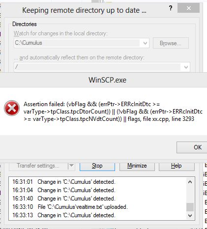

Oh well, I haven't got round to setting up the script yet and KRDUTD has failed again.
This time it was at approx 00:45 and I didn't notice until 02:25 (fortunately I was up late otherwise I would have lost another 6 hours possibly).
It failed with a "Invalid Pointer Operation" this time, although again WinSCP doesn't fail just the KRDUTD function, which can't be restarted because although it recognizes the change to directory it won't do the FTP any more so winSCP has to be restarted.
It is a dynamic log covering approx. 4 hours so, unless there is some other file somewhere, I can't tell how long it had been running prior to it failing. Well, that isn't exactly true as it had been going since I restarted it after the last failure so about 18 hours.
The system hadn't been used in that 4 hour log period though (about the same as the last time it crashed) and as there is one FTP per minute, which equates to >240, I don't suppose there is some 256 threshold somewhere where it is failing?

I am using the version of WinSCP 5.1.4 (build 3020) and I am running under Win8.
The problem seems to be random although I have never had it happen while at the system, it is always after it has been running for some time when my win id is locked, no one else is using the system and typically, apart from WinSCP, only my weather software running (invariably during the night, unfortunately). I don't remember if the first occurrence was the same but the last three have been "Invalid Pointer Operation" and the error box appears twice. On removing the error box, I can restart the krdutd function and it detects that the file has changed but it doesn't FTP it. I have to exit WinSCP and restart it.
To be honest, I am more interested in running the script as, in theory, I have more control over it but I don't know how to ensure that the initial synching doesn't occur. I just need the ability to transfer a single (the same) file every time it changes (once a minute) but I don't have the control over the original placement of that file otherwise I would put it in a local directory where it was the only file.

Latest failure, instead of 2 x Invalid Pointer Operation, got one of those with a...
Access violation at address 74F21EF3 in module "KERNELBASE.dll" Read of address 03550000
...over the top

Having received debug version, run it with problem occurring and having sent debug output...
Have again had problem with Invalid Pointer Operation messages plus never ending...
Assertion failed:FTerminal-> OnReadDirectory==DoReadDirectory, file Components\UnixDirView.cpp,line573
...messages.
Have sent you email with location of new debug log file.
