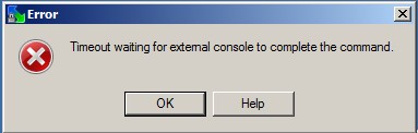

Timeout waiting for external console to complete the command
i'm using VB.NET to put the file. i have lot of files (more than 100 files) at one time.
but i'm receiving this ERROR and it's killing my time.
ERROR: Timeout waiting for external console to complete the command.
if i put false for
RedirectStandardOutput = False
no problem to transmit the file. but i need to capture the log information.
please help me on this.
Description: Timeout waiting for external console to complete the command.

It sounds like you are not continously reading output from winscp process, so the output buffer gets full and process hangs. For details see:
https://winscp.net/eng/docs/guide_dotnet#output
Anyway, I would recommend you to use WinSCP .NET library instead. It does all this for you.
https://winscp.net/eng/docs/library
