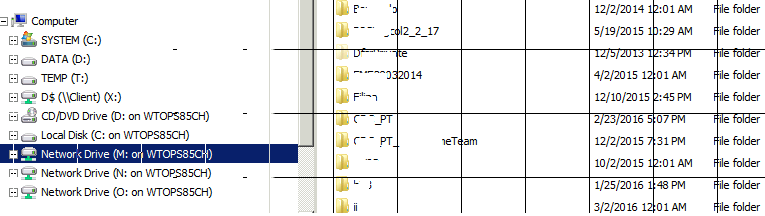

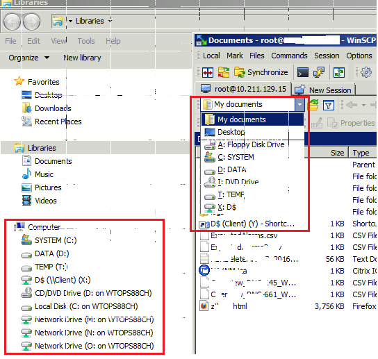

To explain the situation :
We are connected on machine WTOPS85CH.
Then we run a Citrix connection to another server from where we use WinSCP.
That's why we can see two C: drives (first one is the local C: of connected server, the second one is the C: from the original server).
From this connected server where we use WinSCP, in Explorer M: is a Network Drive and is accessible (check attachment1).
But in DOS, this M: is not visible :
D:\>dir M:\
The system cannot find the path specified.
D:\>
So do you think I can find a tip to see them in WinSCP?
Thanks
Murz
I do not know how Citrix works.
To see a drive in WinSCP you have to map it to a drive letter. Those drives are not mapped (contrary to the subject of this topic).

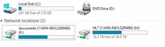

Mapped Drives not showing
Hi, I just downloaded version 5.9.6, which i previously had on my computer but got a new harddrive. Running Windows 7. I can no longer see my mapped drives when I am in the FTp, only C and D drives.
Re: Mapped Drives not showing
@SummerK: Show us a screenshot of both WinSCP and Windows explorer. Make sure both are running with the same privileges.

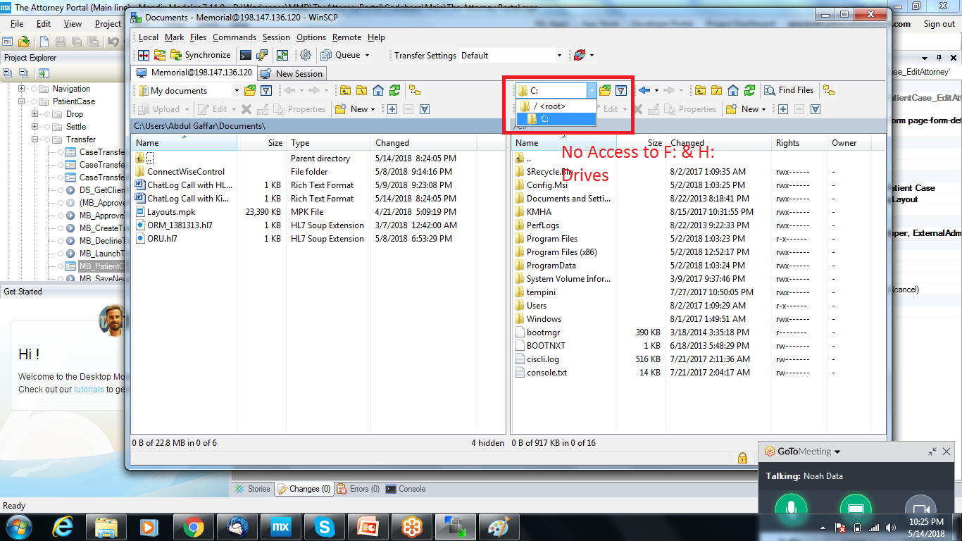

Re: I am having this same issue on version 5.13.1 (Build 8265)
@Xero: But that's a server-side panel. What folders (or drives) do you see on the server, is all about server configuration. That has nothing to do with WinSCP.
Re: Reply
@Xero: I understand that. But that fact that your remote system has the drive mapped, does not mean that FTP/SFTP server have to expose them the a client. That's all about how the FTP/SFTP server is configured. And that has nothing to do with WinSCP.

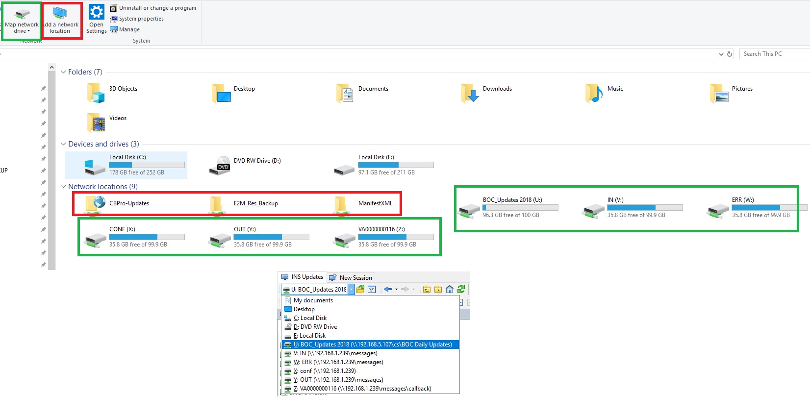

Upgraded from WinSCP 5.15.3 to 5.15.9, mapped drive missing
Just upgraded from WinSCP 5.15.3 to 5.15.9; mapped drive previously visible in WinSCP is no longer visible for selection & use.
**Update: while not able to see/select mapped drive, was able to browse to the mapped drive's actual address under "Network" & connect there. While issue is resolved, would still like to know if possible to view mapped drives in 5.15.9 version.
