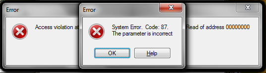

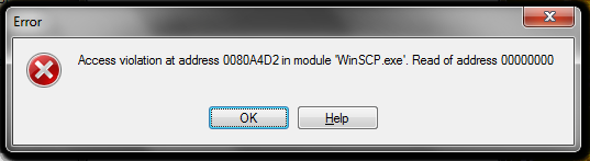

I'm able to consistently reproduce this problem. If WinSCP is connected to a server and my computer goes into sleep or hibernate, when I resume the computer and switch to WinSCP, it starts throwing this unending foray of 'access violation' messages. I am forced to find the WinSCP process in Task Manager and end it. There are two messages that repeatedly pop-up as several numerous copies.
Screenshots (taken with some pain) are attached. I will send you an email so that you can send me a debug version.
Description: Access violation at address 0080A4D2 in module 'WinSCP.exe'. Read of address 00000000
Description: System Error. Code: 87.
The parameter is incorrect

Sorry Martin, it looks like this bug had been fixed in a later version (I updated to 5.1.7). Silly me, I didn't update WinSCP [Talking about which, you might want to consider an automatic update solution, or at least download and launch the installer right from the 'Check for updates' function.]
I'm not a 100% sure it's fixed, but if I get it again, I'll report it (after updating and reproducing the error :) ).
