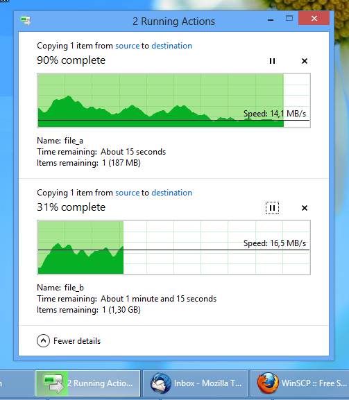

Regarding the overall progress bar for "Transfer each file individually", a queue counter is certainly an improvement. However, one of the features I like most in windows 7, is the overall progress bar, that is automatically displayed on the task bar icons. So, I often minimize the application and still can see the operation progress which is currently not possible in WinSCP if you're using multiple queues or the "Transfer each file individually" mode.
First, WinSCP shows number of items in the queue on the taskbar button (when WinSCP is in background). I believe this gives you the feedback you want.
Regarding your reference to Windows progress bar: It's not really a fair comparison as Windows 7 does not have a queue of transfers. It's displaying progress of single transfer only (equivalent to single line in WinSCP queue). When Windows shows single progress for multiple parallel transfers (Windows does that when its groups multiple buttons into one, when taskbar becomes crowded; Windows 8 does this always), it's not doing any good job as it shows progress of the least "progressed" transfer only (see attached Windows 8 screenshot). I believe this is not what you seek for.
It's not really easy to show overall progress of multiple tasks that potentially start at a different times (new tasks can be added while others are still running). How would you calculate it? I have some idea, but it is not straightforward to implement. Maybe you have better :)

And I guess you're right, I never realized that windows only reflect the progress of one task. From my experience, in most cases it doesn't make a big difference though, because if you split an upload into several equal parts, they will take a fairly similar amount of upload time. Of course, that may be differ for users with other requirements.
It's not really easy to show overall progress of multiple tasks that potentially start at a different times (new tasks can be added while others are still running). How would you calculate it? I have some idea, but it is not straightforward to implement. Maybe you have better Smile
What I would expect is that the overall amount based on transfered data (Not time) is displayed. So, for example assume that there are 3 upload threads given:
1.) 1 GB overall, 100 MB already uploaded (currently 10%)
2.) 500 MB overall, 300 MB already uploaded (currently 60%)
3.) 4 GB overall, 1 GB already uploaded (currently 25%)
If you just build the average of all percentages you would get: ((0,1 + 0,6 + 0,25) / 3) = ~0,31
But this approach doesn't reflect the overall progress very well because it doesn't consider the different amounts of data for each thread.
A much better approach would be to consider the data amounts which would result in: ((100 + 300 + 1000) / (1000 + 500 + 4000)) = ~0,25
which reflects a far better status from my point of view.
Regarding adding new tasks during runtime: Well, you would see a jump in the progress bar if you do that. But that's what I would expect because for me that feels natural.
Whether tasks that are on hold with a scheduled upload time are considered or not is certainly a design question. Personally I would consider these tasks too, but other people may have other opinions here.

I'd do it the same way you suggest.
I just do not really like how adding new tasks may have different affect on the progress indicator.
Imagine you tun 10 hours upload. When you are 99.99% done, you add another 10 hours upload. That means that your progress drops to about 49.9% and stays there even when the first upload finishes after 10 seconds. While if you wait those 10 seconds before starting the second upload, you would naturally expect (starting with empty queue) that the progress indicator starts as 0%. To me it looks strange how those 10 seconds difference have a lasting impact on progress display for 10 hours. Though I admit that this is an edge case.
Another complication is that for recursive downloads, WinSCP has to query the server to retrieve the download size. Currently, it does that only once the respective tasks starts. While to calculate the total progress, it would have to do it at the time the task is added to the queue. What is not a trivial change. Either it has to do it on foreground (what may block the main window for a while) or it would have to open an additional connection to run the query on (what may need to breache the user preference on maximal number of opened connections).
