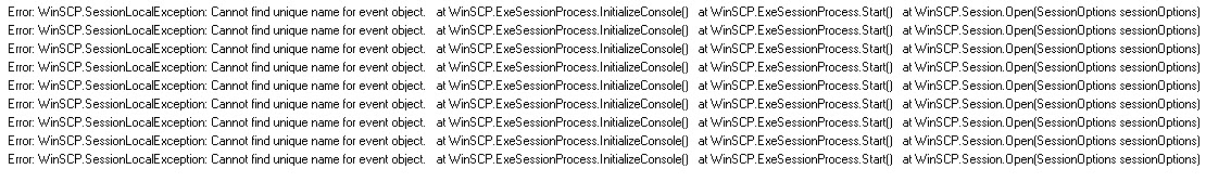

I got message Cannot find unique name for event object.
how to resolved problem ??

I use WinSCP.NET assembly and i try connect synchonize SFTP multi thread. i got message some thread when connect SFTP.

Do I understand right, that you get this randomly, now and then?
How many threads in parallel are you running?

I want to use about 100 threads.

Download WinSCP .NET assembly source code and modify the ExeSessionProcess.InitializeConsole() to reduce chance of this happening. You can increase MaxAttempts or possibly add object's hash code to _instanceName.
I'll improve this in the next release.
