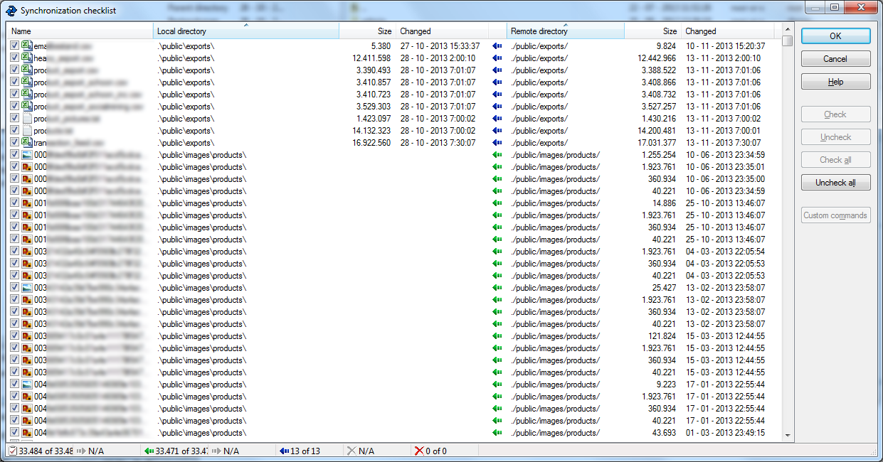

Hi!
I'm using the newest version of WinSCP and I'm trying to exclude a couple of directories from syncing but I can not get it working. I've set the following excludes:
Excluding files:
./application/exports/*
./application/logs/*
./public/images/products/*
./public/uploads/*
.\application\exports\*
.\application\logs\*
.\public\images/products\*
.\public\uploads\*
Excluding directories:
./application/logs
./public/uploads
.\application\logs
.\public\images\products
.\public\uploads
But after all those rules it's still trying to transfer those files (see attachment). Anybody who has an idea what I'm doing wrong?
