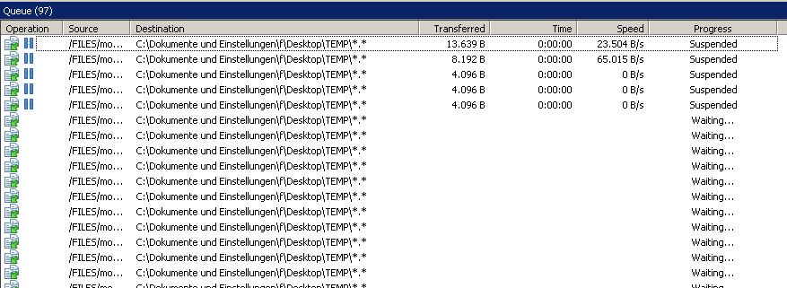

Look, this happens, when I have a long list and I go to All / Cancel:
See attachment "Transfer List".
Only the actual transferred files get suspended, all the "Waiting" are untouched.

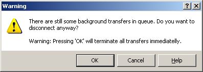

When I quit WinSCP I get this:
See Attachment "Quit WinSCP"
This should be possible without quitting WinSCP.
Clear now?

I understand that Cancel All command is needed. Will add it.
But you talk (also) about Suspend All, what is like "pause", not "delete". And there's no need to "pause" transfers that are not transferring yet.
