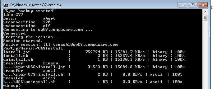

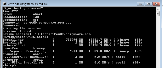

Hello am not able to exit from the WinSCP.
Even the exit command itself not taking.
If use the exit command before the put, it is working, but if I call the exit after the put it not getting out of the WinSCP.
