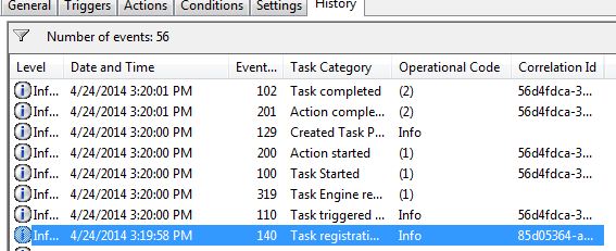

The script file (testScript.txt) has the set of commands that downloads the file to network drive. I tried the same thing you just said but I get 0x1 error code as the result. I have attached a snapshot of the history of the task been executed. I am not sure of where am i going wrong.
Description: this is the snapshot mentioned.
