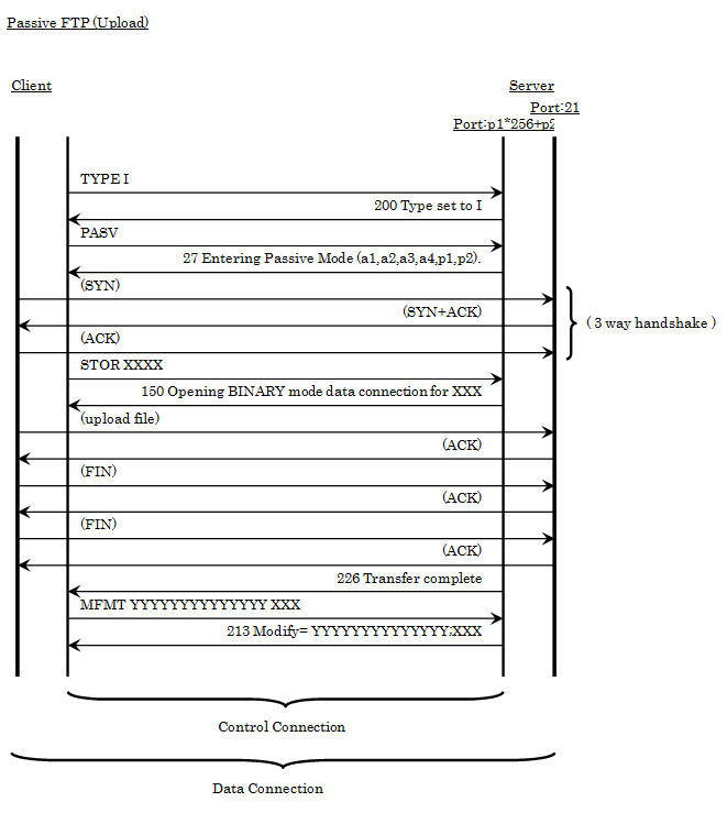

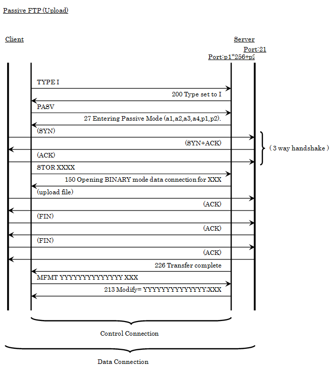

Re: WinSCP: Timeout occurs in upload of files of Passive Mode.
Sorry.
I attached Figure.
I want you to check the following things.
Before the connection initiation (three-way handshaking) of a data connection is completed, does WinSCP send STOR command through the control connection?
Can this be checked with the log file of WinSCP?
Thank you for your consideration.
No. WinSCP connects only after sending the STOR command.
