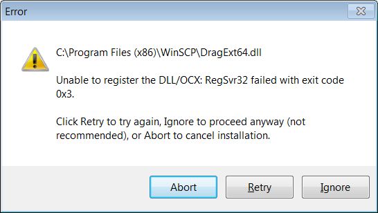

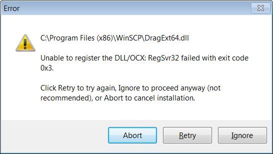

Every time I try to install this I get an Error
C:\Program Files (x86)\WinSCP\DragExt64.dll
Unable to register the DLL/OCX: RegSvr32 failed with exit code 0x3.
Have tried multiple versions of the software and get the same error on each. 5.5.5, 5.5.6, 4.2.17 all fail.

What happens if you do regsvr32.exe "C:\Program Files (x86)\WinSCP\DragExt64.dll" from Admin command-line?
bala
This is during the end of the installation phase. If I hit ignore it seems to install fine, I can then re-reg the DLL after it has installed and it succeeds. I have tried installing this on several different systems and get the same error on all of them.

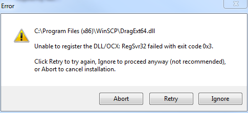

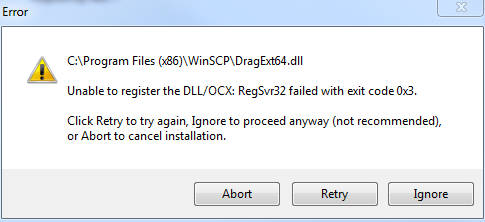

Unable to register the DLL/OCX:RegSvr32 failed with exit code 0x3.
I ran into this issue today installing version 5.13.3. So I did some testing and found that if I removed the ".exe" from the regsvr command that it would work.
This command does not work and results in the error:
This command DOES work:
regsvr32 "C:\Program Files (x86)\WinSCP\DragExt64.dll"

Thanks for sharing this. What do where regsvr32.exe and where regsvr32 say?
