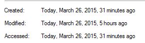

I don't know if this is related but the datetime of the file at the end of the process is 4 hours earlier than the current time at the beginning.
If I create a file at 4:00P and then use this program to ftp it, when it ends up in the destination folder, the datetime on the file is 12:00P. If I look at the properties, it says:
created: 30 minutes ago
modified: 5 hours ago
accessed: 30 minutes ago
(see attached jpg)
Thanks for your help
Nat
Do you refer to upload or download? I assume that download, as you do not seem to upload at all.
Can you attach a log file showing two consecutive synchronizations, where at least the first synchronization actually downloads some file (with wrong timestamp) and the second synchronization either downloads the same file or determines that the file does not need synchronization? Please mention a name of the file I should look for in the log file.
