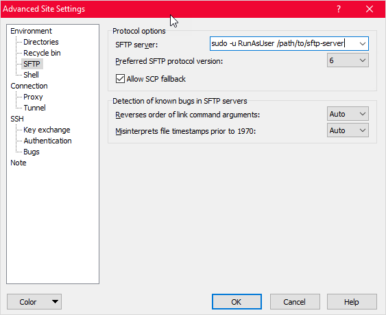

tedious
How to sudo as a different user in WinSCP
Posting the solution as obviously the top result for searching online falls on an admin that is unable to provide the simple answer...
Quick answer:
sudo -u RunAsUser /path/to/sftp-server
To locate /path/to/sftp-server:
locate sftp-server
which sftp-server
If both command fails, try the paths in the doc: https://winscp.net/eng/docs/faq_su
Long answer:
Basically the SFTP server field in Advanced Settings is a command line, so you only need to add the command to sudo as another user.
What is suggested in the official doc is to just elevate sftp-server permission to root (default value if -u is not provided). As -u is not required for root, it can get confusing as to how to set up the connection as another user.
  • Elevate sftp-server to root permission.
    Requires the permission to be set in sudoers.conf
    sudo /path/to/sftp-server
  • Elevate sftp-server to another user permission
  • Another command that I found being passed around is
    sudo su RunAsUser -c /path/to/sftp-server
    It achieves the same thing in a different manners. Either worked for me.

Hello team,
I am using latest WinSCP v5.21.5 on my Win10 box.
I try to connect to a Linux (Red Hat 8) box. From ssh command line, I can login as a user A , which has (ALL) NOPASSWD: ALL permission. Then sudo to another non-root user B, without pwd. For example, as user A, I can run sudo -u userB whoami without pwd.
Now I wish to use WinSCP to login as A and sudo to B, then r/w files owned by B.
With WinSCP, if i use "File protocol=SFTP" => Advanced Environment, SFTP,"SFTP server = "default" or /usr/libexec/openssh/sftp-server, I can access directly as user A no problem.
I have tried to use "File protocol=SFTP" => Advanced Environment, SFTP, SFTP server = sudo -u userB /usr/libexec/openssh/sftp-server or sudo /usr/libexec/openssh/sftp-server.
Then I am getting "Connection has been unexpectedly closed error" with "Cannot initialize SFTP protocol. Is the host running an SFTP server?" msg.
It is definitely not pwd wrong issue. If I use wrong pwd, I will get "Access Denied" first.
Thank you for any advice.

Re: How to sudo as a different user in WinSCP
@Guest: Ok, and what if you do this from the local machine?
ssh userA@example.com sudo -u userB /usr/libexec/openssh/sftp-server
If I run exactly this command:
ssh 424956@merch1as1uu sudo -u aabchua1 /usr/libexec/openssh/sftp-server
sudo: sorry, you must have a tty to run sudo
I have to use -t option for ssh, than that works:
ssh -t 424956@merch1as1uu sudo -u aabchua1 /usr/libexec/openssh/sftp-server
Thanks it works after I comment out the Defaults requiretty in /etc/sudoers. This is a RHEL6 box. By default the TTY is "required".
Sems RHEL7/8 boxes do not requiretty anymore. That is why they are all good.
Thank you so much for your assistance!
