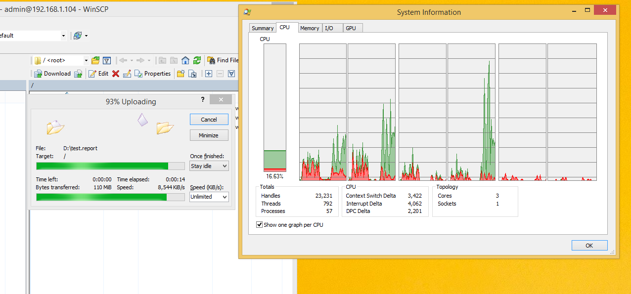

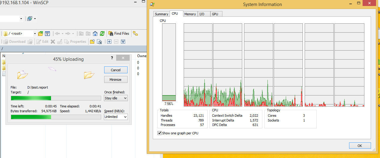

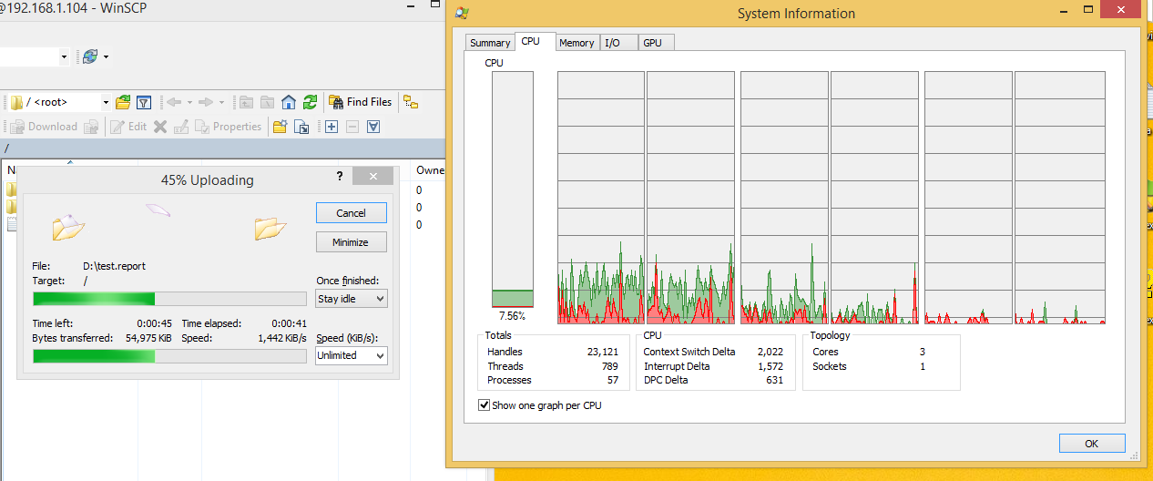

yes I'm pretty sure the problem should be something else, I attached 2 screenshots from my cpu usage during file transfer for both 5.2.5 and 5.2.4, actually my cpu usage is much higher in 5.2.4 (which is understandable because of higher file transfer speed)
System Specification:
AMD FX-6100, 4GB Ram
Windows 8.1 x64
Description: WinSCP 5.2.5
Description: WinSCP 5.2.4
