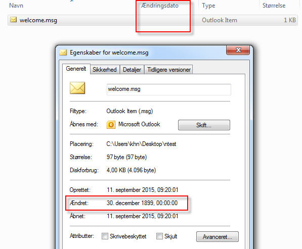

I am struggling with a wrong Last Modified timestamp when downloading from one specific server using the command line version of WinSCP. Regardless of which file I download, the date in Windows is set to 1899/12/30 0:00:00 (and shown as blank in the file explorer - see image). This only happens when downloading from one specific server and only when using the command line version or the .NET assembly. I actually noticed this when using the .GetFiles() method in the .NET assembly and then switched to WinSCP.com to see if the problem was the same - which it is. However, if using the UI, the timestamp is preserved correctly.

I noticed that it shows the 1899 timestamp at log entry 09:20:01.577. I also confirmed that if performing a "list" command the returned timestamp is correct, but using "stat" it is wrong.
Any idea about how to work around this?
