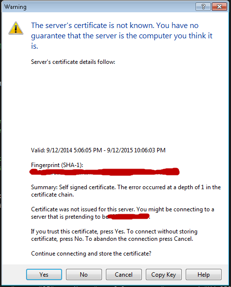

I am attempting to use FTP with TSL/SSL implicit encryption within a C# .NET application. My application hangs and then eventually times out when I try to establish a connection. This is probably due to the certificate warning. The error message is:
Self signed certificate. The error occurred at depth of 1 in the certificate chain.
I came across another post on this forum (https://winscp.net/forum/viewtopic.php?t=11254) which mentions the SessionOptions.SslCertificate and setting the fingerprint but that property is not available from the version of the library I'm using.
What can I set in my code to accept the warning and establish a connection?
Thanks.
