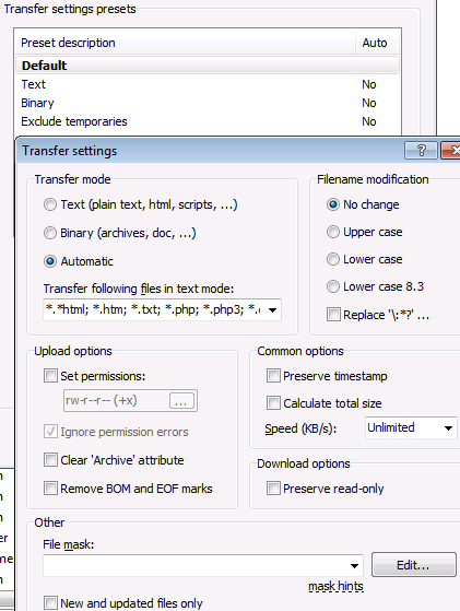

Using WinSCP Version 5.7.5 (Build 5665)
Protocol: SFTP
Port: 22
Error occurs Uploading file to NetApp server
Error occurs both using WINSCP GUI and command line interface
No errors occur downloading files
File size is relevant to the error:
Files under 10K: Error never occurs
Files 10K – 50K: Error is intermittent, occurring more frequently as the file gets larger.
Files 50K-100K: Error occurs almost all the time
Files > 100K: Error occurs all the time.
Whether the file is uploaded as binary or text is not relevant.
When the WinSCP GUI displays the error window, I click “Abort” and the file transfer operation completes.
The error is associated with the server handling of the SSH_FXP_CLOSE command. The server returns the status message: “no such file”, so the client logs: “Cannot Close Remote File”.
After I click “Abort” to the error, the server returns a directory listing (that includes the uploaded filename) without error.
NOTE: I have turned off temporary file renaming from the client to prevent uploading to a temporary filename and then renaming at the end of the transfer. That was a problem in the past because the FTS server does not allow file renaming.

Hello @martin – thank you for your reply,
I tried your suggestions: "disable preserving timestamp/setting permissions" (please see attached)
and still get the error.
The error does not occur with other clients e.g. CoreFTP.
Description: Transfer Presets
richwink
5
Hello @martin here is the log file your requested. I unchecked all the "Common options" including "Preserve timestamp" and also unchecked all "Upload Options". I did this for the "Transfer Settings" of all "Presets" i.e. "default", "Text"...etc.
I get the exact same error.
I have attached the entire log from startup of WinSCP to after the file is uploaded.
Below I've pasted a truncated portion of the log from the end of the file upload to after I click "Abort" to the error message and the file finishes uploading.

I wrote similar code in the wrapper I built for WinSCPnet.dll. The error generates an exception which is caught in the exception handler and then ignored. This works for our automated uploads as the file upload does complete even after the exception.
But there is no workaround, that I can see, for manual uploads using the WinSCP GUI, except to click "Abort" or "Skip" in the error window popup.
Is there a setting in the WinSCP configuration that can be set to bypass this error? If not, would it be a good idea to add one to a future release on WinSCP?
Thanks - Richard
I do not think so. It's clearly a bug in the server. So, it should be fixed on the server.
