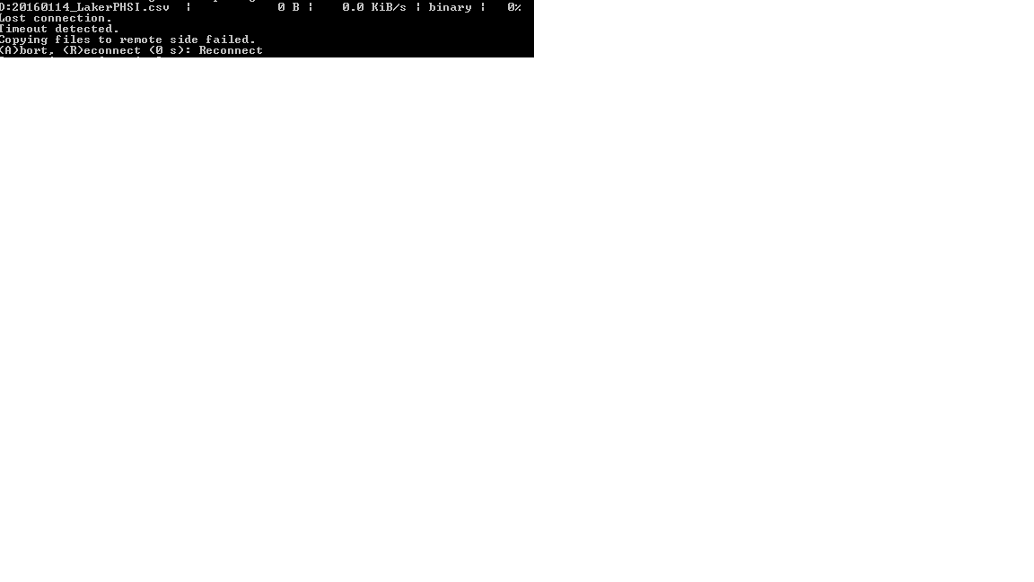

I am kind of new to using command prompt for winscp. If someone can please help resolve my error below it would be greatly appreciated. As I don't know what steps to take next and I have looked through all of the other boards. WINSCP version 5.5.6.0.
option batch abort
option confirm off
open ftp://username:password@server -passive -explicitssl
put "local file" "destination folder" exit
"Copying files to remote side fialed".If you need the working log, please instruct me on how to get it.

It looks like the server is misconfigured or something is blocking a connection to the server.
Did you read the
https://winscp.net/eng/docs/ftp_modes
as recommended by a documentation to the error message "Timeout detected" that you are getting?
https://winscp.net/eng/docs/message_timeout_detected
Yes, I read the ftp modes article and there is more than one attempt to getting the file. I don't think the amount of time provided will solve this issue.
