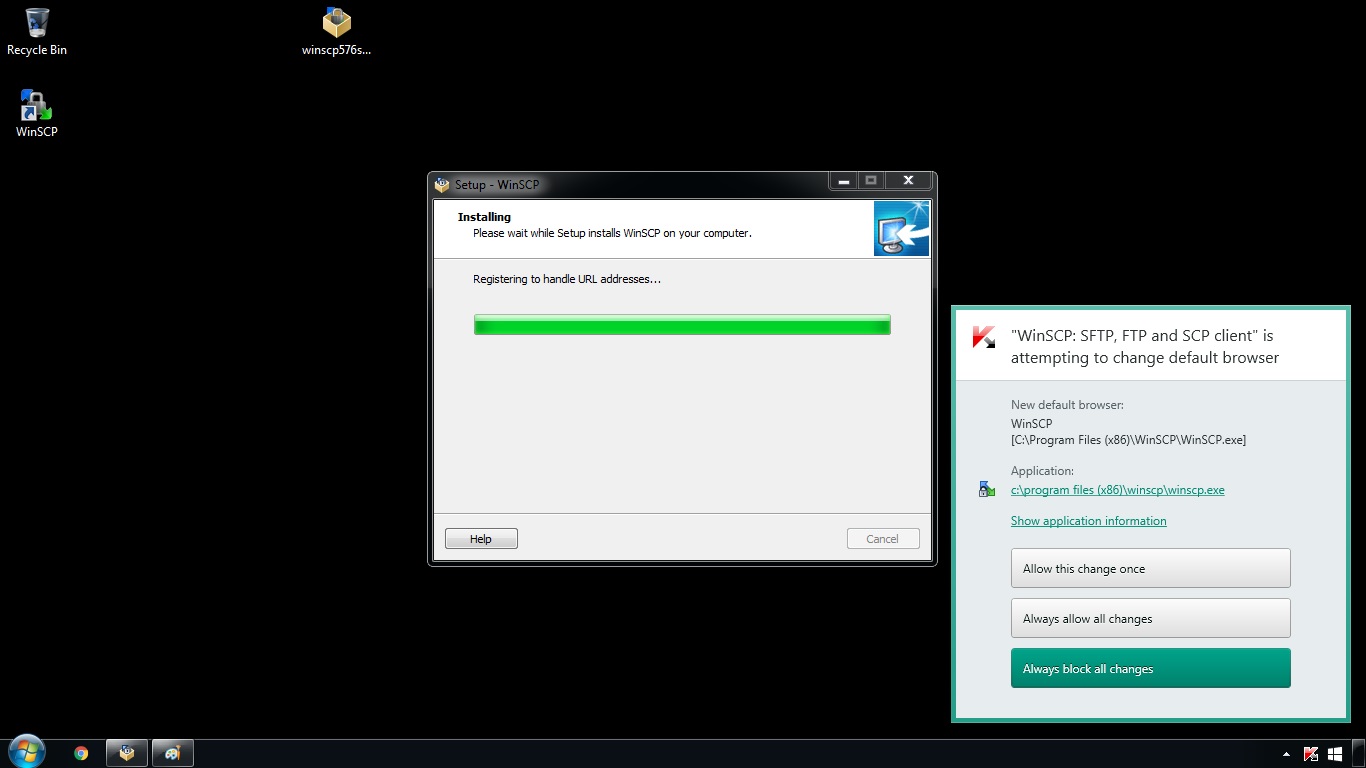

When I install WinSCP 5.7.6 on my W7 pc, Kaspersky reports a browser hijack event at the end of the installation process. Is this normal. I'm thinking it could be a faslse/positive. This is the first time I have used FTP software.
I downloaded WinSCP from the official website, and checked the Checksums.

Can you show us a screenshot of the report?
Sorry for the delay
Please find attached a screen shot of the report.
Thank you.
Re: Browser HiJack reported by Kaspersky
WinSCP is registering for FTP protocol. Maybe that's what Kaspersky considers suspicious. WinSCP definitely does not try to register for HTTP.
