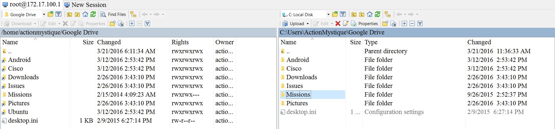

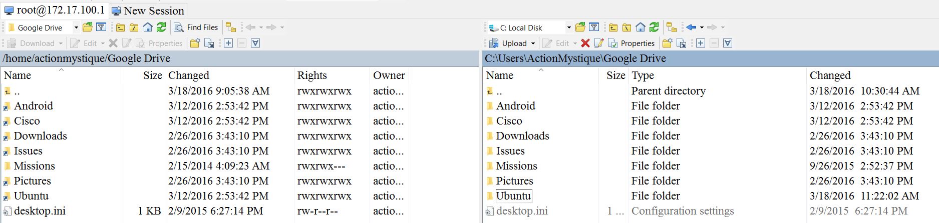

Timestamps are not correctly synced for previously synced folders Linux -> Windows

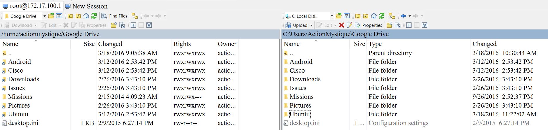

As you can see in the "Sync Results" screenshot, all timestamps of new symlinked folders are correctly set, but the timestamp of the "old" non-symlinked "Missions" folder has not been set correctly.
Also "filter mask" screenshot and log in next post.
BTW, why limit the number of file uploads to 3?
Description: Sync Results

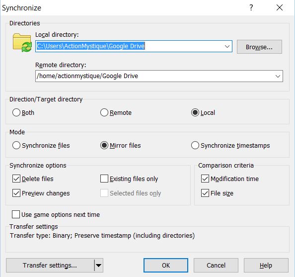

Description: Sync Options

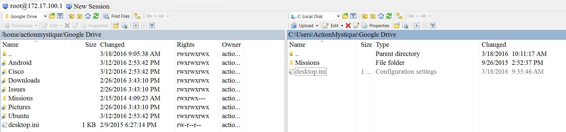

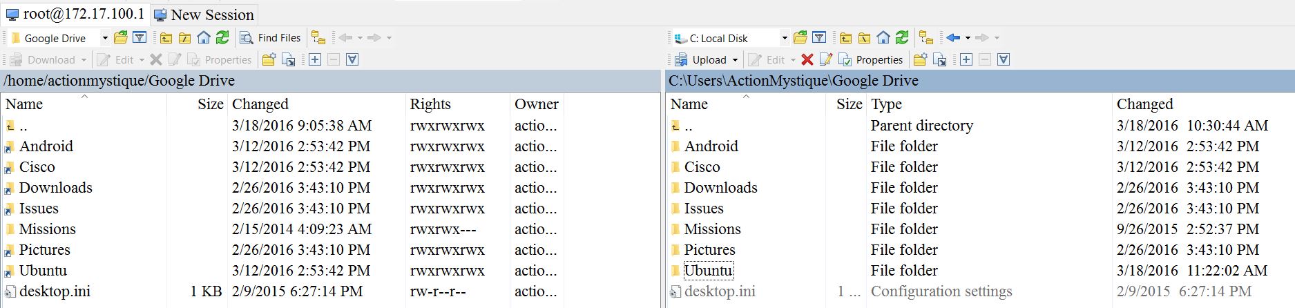

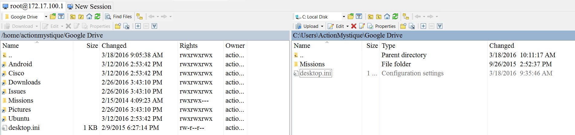

Description: Before Sync

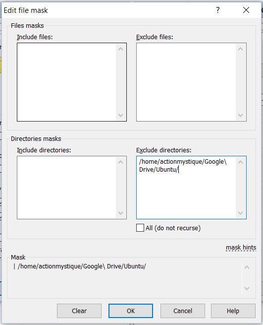

Regarding "Ubuntu", I have deleted afterwards all synced folders inside it, hence the modified timestamp.
It has been synced despite the excluded filter mask.
I'll try again with a different mask, without the escape character.

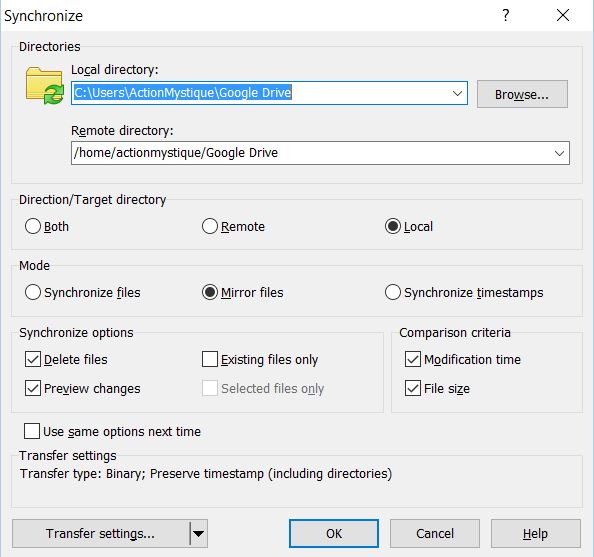

Description: Filter Mask

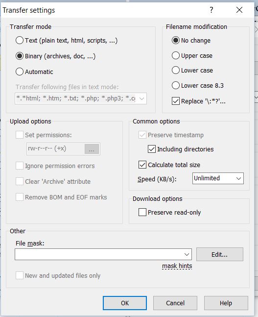

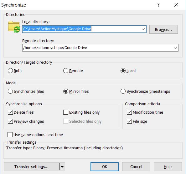

Did you have the Preserve timestamp > Including directories checked? Can you attach a log file showing that?
43,037
Re: Timestamps are not correctly synced for previously synced folders Linux -> Windows
I apologize for not replying sooner. I somehow missed this.
If I understand correctly, you want WinSCP, while synchronizing files, to synchronize timestamps of their parent directories. As of now, WinSCP only sets directory timestamps, when uploading a new directory, not when adding (or otherwise updating) files in an existing directory.
I'll see if more people ask for this.
