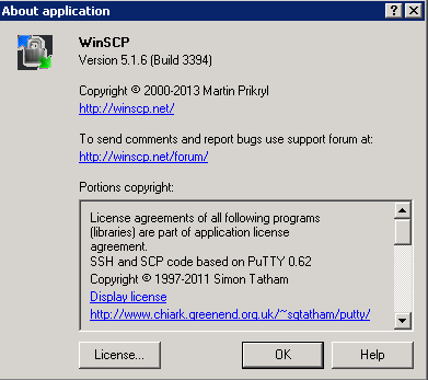

Description: winscp version

Please attach log files both from the GUI and the script, showing the different behavior.
Make sure you use the latest version of WinSCP for the test.
