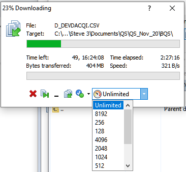

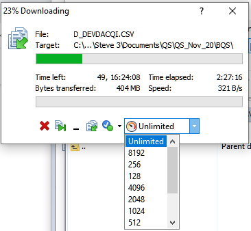

Could this be related to the transfer speed dropdown?
Although I like WinSCP very much it seems to disconnect and reconnect for me every 15 seconds as other posts have noted.
I found that, oddly, if I clicked the speed limiter dropdown and left it down, the disconnections didn't happen at all. However the transfer speed slowly dropped away to a couple of hundred bytes/sec.
I hope that may offer some kind of clue as to what is happening...ahh, maybe it is just that selecting the speed limiter pauses the transfers altogether...back to the drawing board.
