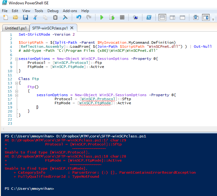

I am having a problem using WinSCPnet.dll with PowerShell, in both ISE and VS2015.
I am running Windows 10, PowerShell V5 (version 5 build 10586 revision 122)
I have the WinSCPnet.dll file in two places, the program files (x86) and in the script directory.
I am using classes within my PowerShell script, which is where WinSCP is not being recognized.
The references to WinSCP within the class fail.
Unable to find type [WinSCP.Protocol]
My script looks like this:
$ScriptPath = $(Split-Path -Parent $MyInvocation.MyCommand.Definition)
[Reflection.Assembly]::LoadFrom( $(Join-Path $ScriptPath "WinSCPnet.dll") ) | Out-Null
sessionOptions1 = New-Object WinSCP.SessionOptions -Property @{
    Protocol = [WinSCP.Protocol]::ftp
    FtpMode = [WinSCP.FtpMode]::Active
Class Ftp
    Ftp()
        sessionOptions2 = New-Object WinSCP.SessionOptions -Property @{
            Protocol = [WinSCP.Protocol]::Sftp
* the references to [WinSCP.Protocol] and [WinSCP.FtpModel] within the class both underlined in RED. (see attachment)
When I run the script within ISE, I get this:
PS D:\> D:\testFTP.ps1
At D:\testFTP.ps1:14 char:29
+                 Protocol = [WinSCP.Protocol]::Sftp
Unable to find type [WinSCP.Protocol].
At D:\testFTP.ps1:15 char:28
+                 FtpMode = [WinSCP.FtpMode]::Active
Unable to find type [WinSCP.FtpMode].
    + CategoryInfo          : ParserError: (:) [], ParentContainsErrorRecordException
    + FullyQualifiedErrorId : TypeNotFound
Within ISE I can "fix" this by typing the command within the script pane:
add-type -Path 'C:\Program Files (x86)\WinSCP\WinSCPnet.dll'
* to update the RED underlines I have to edit something within the code
Within VS2015 community edition, I am stuck. I can't get it to acknowledge WinSCP at all.
I checked my DLL's, and they are not blocked. I registered the DLL and that didn't change anything. I want to stress that WinSCP is working for me outside of a CLASS. Within ISE, if I manually Add-Type to it, then WinSCP will work within a CLASS. This work around does not work with VS though.
What can I do to fix this, and how can I get this PowerShell script to work within VS?
Description: Screen capture of ISE with error text in script box.

Re: Problem using WinSCPnet.dll inPowerShell, when in a CLASS [includes screen capture]
I've never used PowerShell in Visual Studio. How do you do that? Can your post screenshot?
The screenshot your posted in from ISE, but that's solved, right?

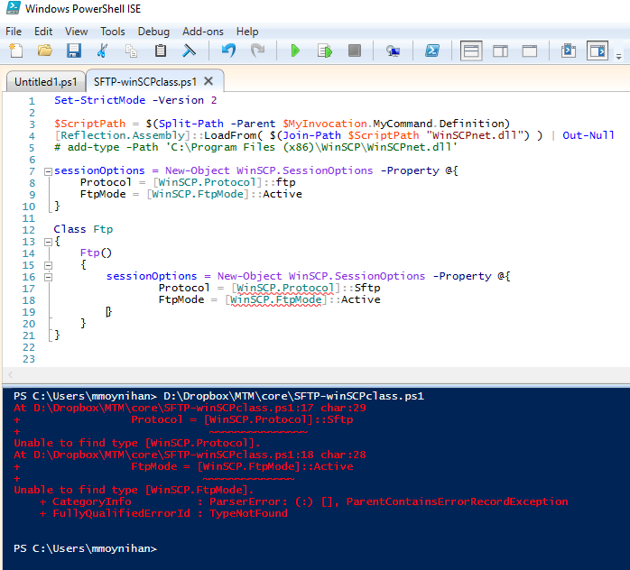

Here is a link: <invalid hyperlink removed by admin>
(screen capture attached)
I installed VS 2015 community edition and selected the 3rd party PowerShell support during the installation. You can add PowerShell support after the install by going to Tools / Extensions and Updates .. search for "PowerShell" and add.
Since I posted, I found that I can make my workaround get me going in VS also.
I am hoping there is a "more better" way to get ISE and VS to see WinSCP when working with PowerShell. Having to manually go into the interactive session to load WinSCP via Add-Type is clunky at best. It means that every time I load a script that uses WinSCP, I can't even run it within the shell until I do this workaround.
Opinion: PowerShell is likely to really takeoff. I am using version 5, and I see it as a best option for automating some of my processes. I am expecting it will become a major player in this kind of development.
(PowerShell Version 5 is included with Win10, available for Win8.1 and Srv2012)
Description: Powershell within VS2015

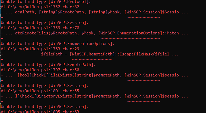

Hi
I have the same problem, only work loading the library from the profil.ps1 file,
I'm using this command but not work, I get the same error.
Add-Type -Path 'D:\PScripts\WinScp\WinSCPnet.dll'
