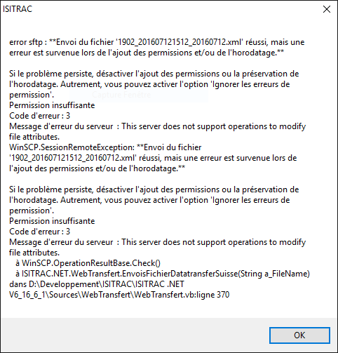

Hi everyone !
I would like to know how to disable the FilePermission Exceptions everytime I'm transfering a file using vb.net
I can transfer the file fine but it throw the permission error when I check. And I would like the check to not throw this error especialy.
I'm using winscp Beta. (last one)
The code where i encounter the problem :
<Creation of the session...>
<Connexion OK...>
Dim transferOptions As New TransferOptions
transferOptions.TransferMode = TransferMode.Binary
transferOptions.FilePermissions = New FilePermissions(300)
Dim transferResult As TransferOperationResult
Dim nomfichier As String = System.IO.Path.GetFileName(a_FileName)
transferResult = sessions.PutFiles(<MyFile>, <PathOnServer>, False, transferOptions)
transferResult.Check()
sessions.Close()
Return True
Catch e As Exception
MsgBox("error sftp : " & e.Message & vbCrLf)

What's the exception exactly?
RTavernier
Thanks a lot Martin for your help,
The solution you gave me is working. I simply forgot to disable preserving the timestamp.
For the permissions I firstly try by not setting them but the system was still giving me the exception.
By doing both, it's now working perfectly fine.
Thanks a lot again
