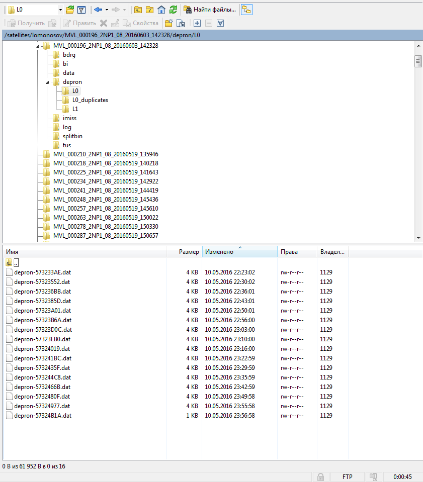

Tell me please how can I download files in several directories with the mask below:
*/depron/L0/depron*.dat
full paths is:
/satellites/lomonosov/MVL_000638_2NP1_08_20160609_010516/depron/L0/depron-5757E576.dat
/satellites/lomonosov/MVL_000638_2NP1_08_20160609_010516/depron/L0/depron-5758207C.dat
/satellites/lomonosov/MVL_000638_2NP1_08_20160609_010516/depron/L0/depron-57585697.dat
/satellites/lomonosov/MVL_000638_2NP1_08_20160609_010516/depron/L0/depron-5757D026.dat
/satellites/lomonosov/MVL_001036_2NP1_08_20160705_013543/depron/L0/depron-577A3159.dat
/satellites/lomonosov/MVL_001036_2NP1_08_20160705_013543/depron/L0/depron-577A19ED.dat
/satellites/lomonosov/MVL_00486_2NP1_15_20160530_093315/depron/L0/depron-574B089E.dat
/satellites/lomonosov/MVL_00486_2NP1_15_20160530_093315/depron/L0/depron-574AB501.dat
When I use that mask in GUI to Select files - it selects only directories, but I don't need a whole tree of directories, I only need listed files.
