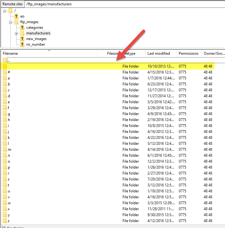

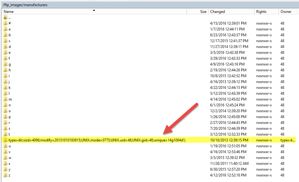

I agree that it looks strange. When I connect using the WinSCP GUI I can see the strange folder in question (image001), but when I connect using FileZilla, the directory name appears to be blank or null (image002). Either way, I would like to know how to just ignore that strange folder altogether if that's possible.

The file has no name, what confuses the WinSCP parser.
You will have troubles excluding it by its full name due to the perceived presence of slashes in the name.
But you can try to use exclude mask like | *modify=20131010193915*
