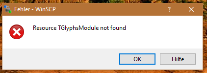

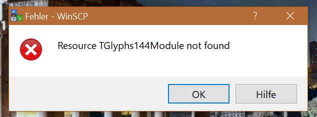

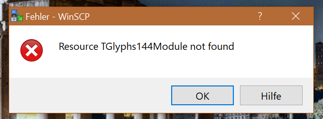

Raziel
Raziel wrote:
So did you try the latest WinSCP 5.10.x beta?
Yes, check attachments.
Check attachments.
I need to relog/restart to get rid of this.
43,048
Raziel wrote:
Check attachments.
I looks like you have copied the winscp.exe from WinSCP 5.10.x portable package to WinSCP 5.9.x installation folder manually. Please use an installer for the WinSCP 5.10.
Or run the .exe form portable package from a separate folder.
