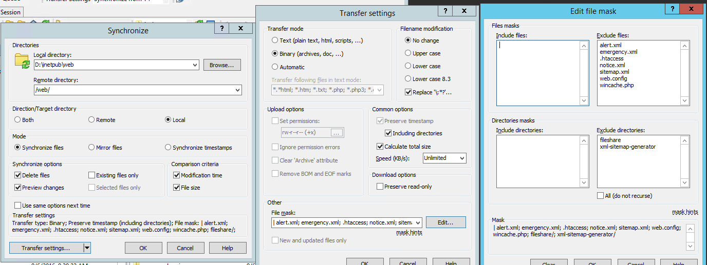

I'm struggling to understand scripting. I can do exactly what I want in the GUI but can't figure out how to script it all. I'm connecting to an SFTP server with a private key and synchronizing files remotely to a local copy. It works awesome in the GUI but I need to setup a script to run every hour. I have attached a screenshot of all the settings I'd like to have in the script. Could someone be so kind as to help me out or point me to a good example of everything I'm trying to do.
Needs:
1. Syntax for opening connection to SFTP server with PPK
2. Syntax for all the options as shown in the attached screenshot.
Here's what I started trying to piece together but I no clue if it's right.
WinSCP.com /command ^
"option batch abort" ^
"option transfer binary" ^
"option synchdelete on" ^
"option exclude "D:\inetpub\web\alert.xml;D:\inetpub\web\emergency.xml;D:\inetpub\web\.htaccess;D:\inetpub\web\notice.xml;D:\inetpub\web\sitemap.xml;D:\inetpub\web\web.config;D:\inetpub\web\wincache.php;D:\inetpub\web\fileshare\;D:\inetpub\web\xml-sitemap-generator\" ^
"open sftp://username@xxx.xxx.xxx.xxx/ /privatekey=C:\scripts\Puttygen\privkey.ppk" ^
"synchronize local d:\inetpub\web\ /web/" -preview ^
"close" ^
"quit" ^
/log="C:\scripts\WinSCP-5.9.1-Portable\t4log!Y_!M_!D_!T.log" /loglevel=0
[/img]

Would be easier, if you explicitly name the options, we should look for.
You are definitely missing the -delete switch for the Synchronize options > Delete files.

I was just reviewing my code and I'm wondering if I have the criteria switch is incorrect.
Documentation states: -criteria=<criteria> Comparison criteria. Possible values are time, size, either and none. Ignored for both mode.
"synchronize local d:\inetpub\web\ /web/ -criteria=both -filemask=""| alert.xml; emergency.xml; .htaccess; notice.xml; sitemap.xml; web.config; wincache.php; fileshare/; xml-sitemap-generator/"""
I have both in there but am I reading the documentation incorrectly? I want it to compare both time and file size. Should I be using -criteria=either instead?
The either is the correct option, as documented.
But the both is also accepted for a backwards compatibility reason, with the same meaning as the either.
