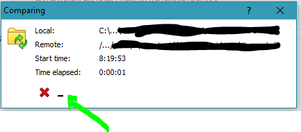

I'm used to pressing "Alt+M" when the Synchronization's comparing dialog appears, with new interface it's now a button with "_" glyph. However the keyboard shortcut "Alt+M" does not work anymore, I have to use mouse to click the icon.
Here is the dialog I'm talking about:
It minimizes if I press the button but not with Alt+M.
Thanks.

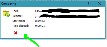

There is one problem with this now, when I hit the ALT+M during synchronization it minimizes, but when the window is restored the main window (instead of the dialog) is active.
Normally if I hit minimize during synchronization the dialog is activated as I restore.
Activating a main window causes interesting side effect, I can start adventurous journey through main window which is not normally possible when modal dialog is open.
What does "normally" refers to? Clicking the button as opposite to pressing Alt+M?
