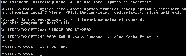

I modified the .exe to .com, it still shows error on the first line and there after.
Please see the screenshot (I'm sorry the first line contains confidential info and is hence excluded from the screenshot but it is like:
C:\WinSCP\WinSCP.com /log="C:\SFTP\log\t4log_!Y_!M_!D_!T.log" /loglevel=0 /ini=nul /command open ftpes://ftpuser:password@sftp.mysite.com/
Thank you
43,192
It's obvious that the batch file is wrong. You have the ^'s wrong. I do not know how else to tell you, to help you to get them right.
Maybe it's time to give up and put everything to a single line:
"C:\WinSCP\WinSCP.com" /log="C:\writable\path\to\log\WinSCP.log" /ini=nul /command "open ftpes://ftpuser:password@sftp.mysite.com/" "synchronize remote \Temp /Distribution/Comp" "exit"
Though the first "The File name, directory name, or volume label syntax is incorrect" error suggests, you might have yet another problem there. I cannot help you with that, if you do not show us the command. You can mask out the sensitive parts. Though, the less information you mask out, the more likely we will be able to help you.
