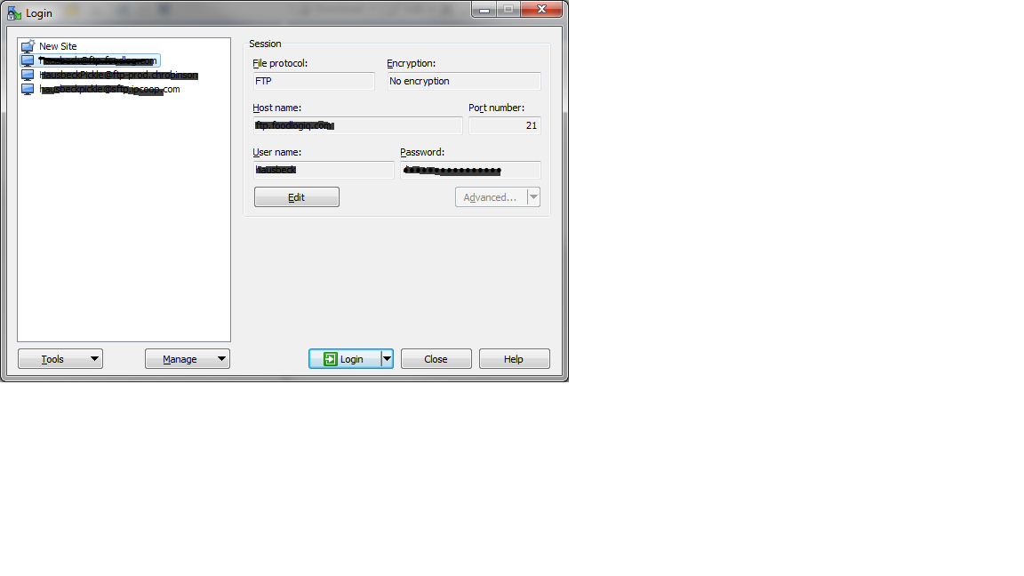

I am trying to make it so that when the task is ran WinSCP automatically can log me in > grab files from specific folders > then push them out to others.
Right now I am trying to figure out a script that will log me in to the system. When I open WinSCP on my own it automatically fills out the login information that I need so all i need it to do is press the login button then I can move onto the next problem of moving the files.
Thank you in advance if anyone can help me figure this out. :lol:
ChadBtz
Saginaw, MI
This is the login screen that I get when WinSCP is opened every time so I need it to automatically press the login button for me since everything is already filled out

Re: OK So....
Sure, you can use a full path in the put command, like put S:\*.* /remote/path/. Or use the lcd command before the upload, like lcd S:\ ... put *.* /remote/path/. Again, that's what the generated script does for you already, had you used the correct directories to generate it!
