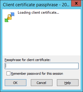

When you try to use that .PFX file with NO password in WinSCP.exe v5.9.3 you will get a windows with "Client certificate passphrase" request (attached).
If you do the same in WinSCP.exe v5.9.1 there will be no problems.
