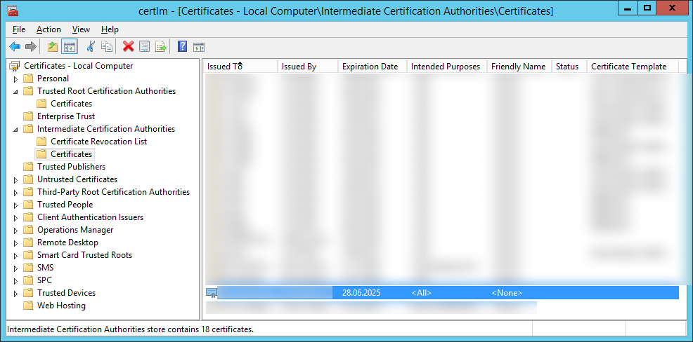

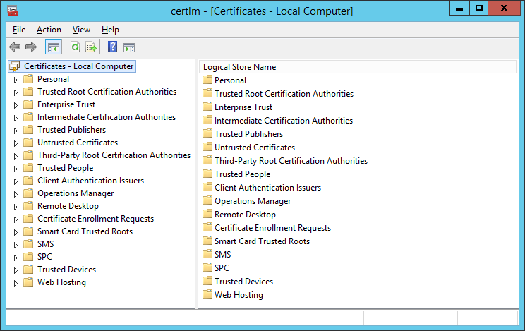

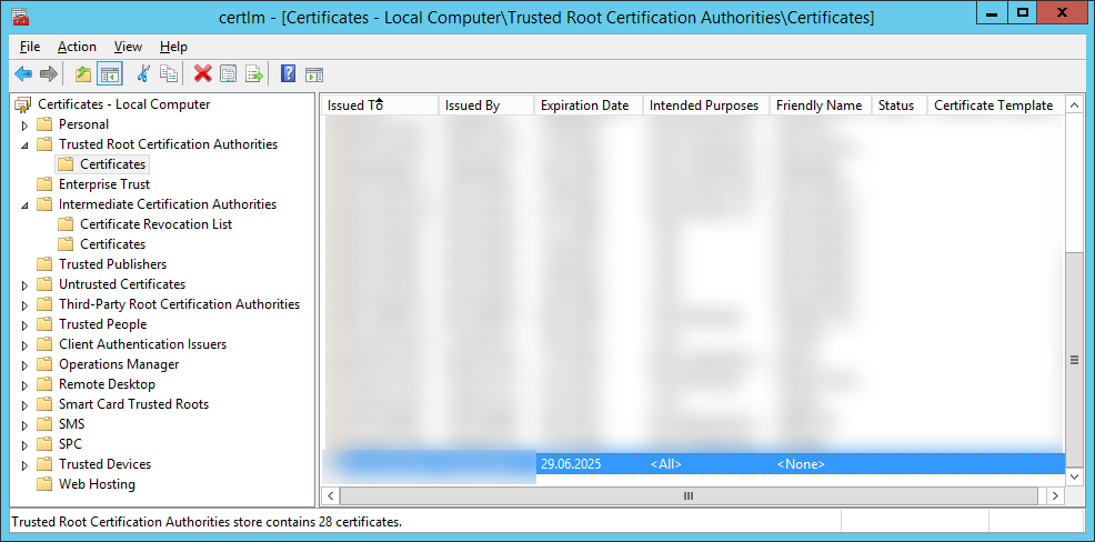

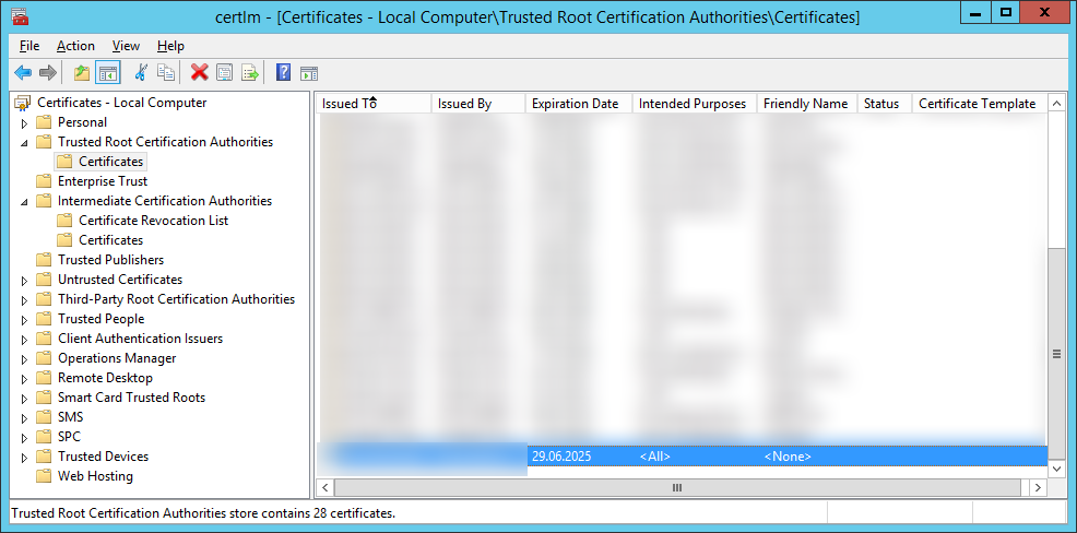

I added my own Root CA and SubCA to Windows storage (see screenshots):
Certificates - Local Computer
- Trusted Root Certification Authorities - Certificates
- Intermediate Certification Authorities - Certificates
Then I remove -certificate="*" from command line which is run from /script=Script.txt
Tried to connect to the Server which has certificate which was signed by my own CA.
And got error - see log attached (private).

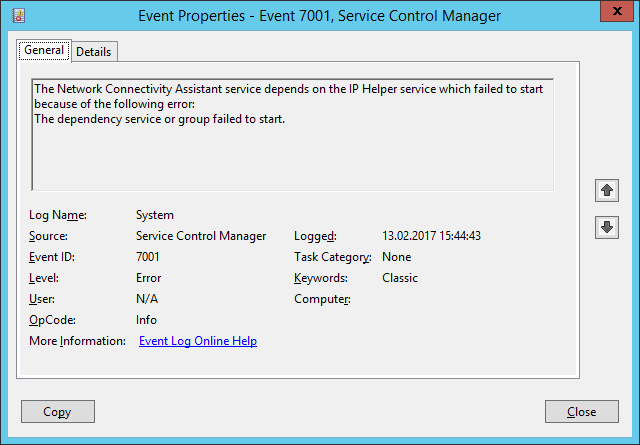

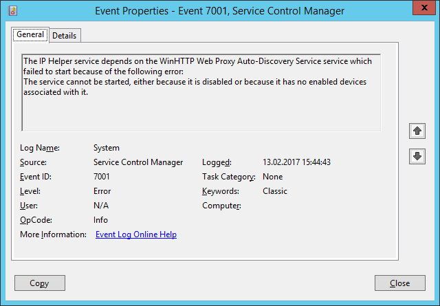

@martin: This API killed my mind today.
Yes, I can see WinSCP uses somehow the Windows Certificates Store.
If you don't have you third-party Root-CA and Sub-CA in Windows store you will get this error in WinSCP logs:
. 2017-02-06 15:38:00.824 Certificate failed to verify against Windows certificate store: Error: 800B0109, Chain index: 0, Element index: -1
When you add your Root-CA and Sub-CA in Windows store you will get this error in WinSCP logs:
. 2017-02-06 17:02:40.025 Certificate failed to verify against Windows certificate store: Error: 80092013, Chain index: 0, Element index: 0
For now I am not able to solve this problem.
The only thing I can tell that using
certutil -setreg ca\CRLFlags +CRLF_REVCHECK_IGNORE_OFFLINE
is not our case as it is only for your own CA you have at your server.
But for 3-rd party Root-CA and Sub-CA certificates this is a problem.
I understand that WinSCP sees the certificates but WinSCP can't do something.
And this something is not clearly for me.
As I have told that when I use cacert.pem it works perfectly.
I need help?! :)

- Root certificate in "Trusted Root Certification Authorities" (I call it CA-ROOT);
- Intermediate certificate in "Intermediate Certification Authorities" (I call it CA-SUB) (SUB is from subordinate).

Add into Windows Storage "certlm - [Certificates - Local computer]" (see screenshot) certificates of your custom CA:
- Root certificate in "Trusted Root Certification Authorities";
- Intermediate certificate in "Intermediate Certification Authorities".
(Start - Run/Search - certlm.msc)

for the Errors:
The IP Helper service depends on the WinHTTP Web Proxy Auto-Discovery Service service which failed to start because of the following error:
The service cannot be started, either because it is disabled or because it has no enabled devices associated with it.
The Network Connectivity Assistant service depends on the IP Helper service which failed to start because of the following error:
The dependency service or group failed to start.
If there is one, turn on (set to Automatic) and then start the service:
Service name: WinHttpAutoProxySvc
Display name: WinHTTP Web Proxy Auto-Discovery Service
Description: WinHTTP implements the client HTTP stack and provides developers with a Win32 API and COM Automation component for sending HTTP requests and receiving responses. In addition, WinHTTP provides support for auto-discovering a proxy configuration via its implementation of the Web Proxy Auto-Discovery (WPAD) protocol.
After that, start the service:
Service name: iphlpsvc
Display name: IP Helper
Description: Provides tunnel connectivity using IPv6 transition technologies (6to4, ISATAP, Port Proxy, and Teredo), and IP-HTTPS. If this service is stopped, the computer will not have the enhanced connectivity benefits that these technologies offer.
You in my case it start working!
