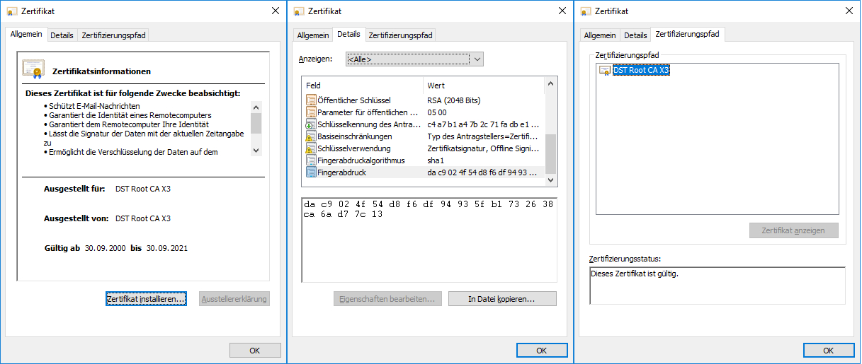

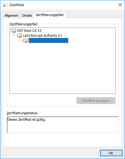

I obviously found a heavy bug. As short as possible:
An intermediate certificate is not trusted (and so the whole server certificate), when it's only referenced through the root CA and not stored within the "trusted intermediate CAs".
When you take the root CA certificate, put it into a cacert.pem aside a winscp.exe (which normally isn't there), the complete chain is trusted.
I assume, when a cacert.pem exists, WinSCP lets OpenSSL check the trust and doesn't use Windows Cert Store.
This is proof enough for me that it only depends on WinSCPs certificate handling when using windows cert store and it's not a bad ftp server configuration.
But anyway, all information and documentation you should need I'll give you with a lot of files:
